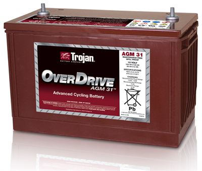

AWESOME link!  Thank you. I just got a screaming deal on 4 AGM batteries and was going to start research on the best way to utilize them.  tymote
Got 4 of these --
Specs and Features:
Type: Group 31 AGM (Absorbed Glass Matt)
102 Ah , 12 V (1,224 Wh Capacity)
730 Cold Cranking Amp Rating
Dimensions (LxWxH): 13.42 in x 6.81 in x 8.40 in (9.21 including stud)
Weight: 69 lbs
Stud Terminal - .64 in Tall
Robust Plate Construction - A thick plate construction makes it more robust and resistant to the stresses encountered during deep discharge cycling. The unique plate design also prevents erosion of the active material which can occur during repeated discharge and recharge, resulting in longer cycle life.
Heavy-Duty Corrosion Resistant Grid - A sunburst array grid design is cast, not stamped, ensuring that no hairline fractures develop during the manufacturing process. The overall grid configuration is optimized to enhance current flow through the grid providing exceptional battery performance. The addition of side and bottom grid wires offer industry-leading vibration resistance.
High-Density Paste - The OverDrive AGM 31 is constructed with a high-density paste formulation precisely engineered to deliver outstanding performance. This high density paste formulation optimizes porosity development utilizing the active material more effectively resulting in longer life.
Rugged Polypropylene Case - Trojan's OverDrive AGM 31 battery is packaged in a thick walled, durable polypropylene case rigid enough to keep the internal components of the battery compressed. The rugged polypropylene case effectively protects the plates from damage caused by shock and vibration, and is resistant to oil, gasoline and other road chemicals.
