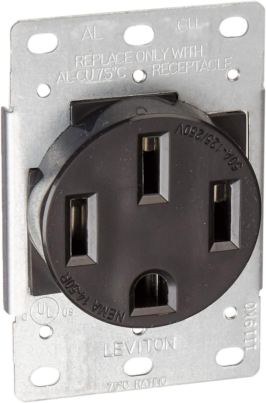

I seem to have a different setup than what DonC13 has.    If I am reading his diagram right, the right hand of the diagram is a receptacle, a NEMA 14-50R , like below:
  So there is 3 outlets in the post?  I thought it might be a typo, but a 14-50P would make less sense. The way that diagram shows, there is a 50A 240V receptacle, a 30A 120V receptacle, and  50A receptacle that only gives you the same leg on both L1 and L2.   (WH)
I defer to others experience, I am new to RV'ing. I have yet to see this setup on a post in my brief time camping in full hookup. I am pretty sure that an outlet wired like that would not pass inspection nor be allowed.
 But if the adapters 'male' side was wired like that, when plugged into a correctly wired 50A outlet you would have a brief 'event' before the breaker tripped from the short.  :beg

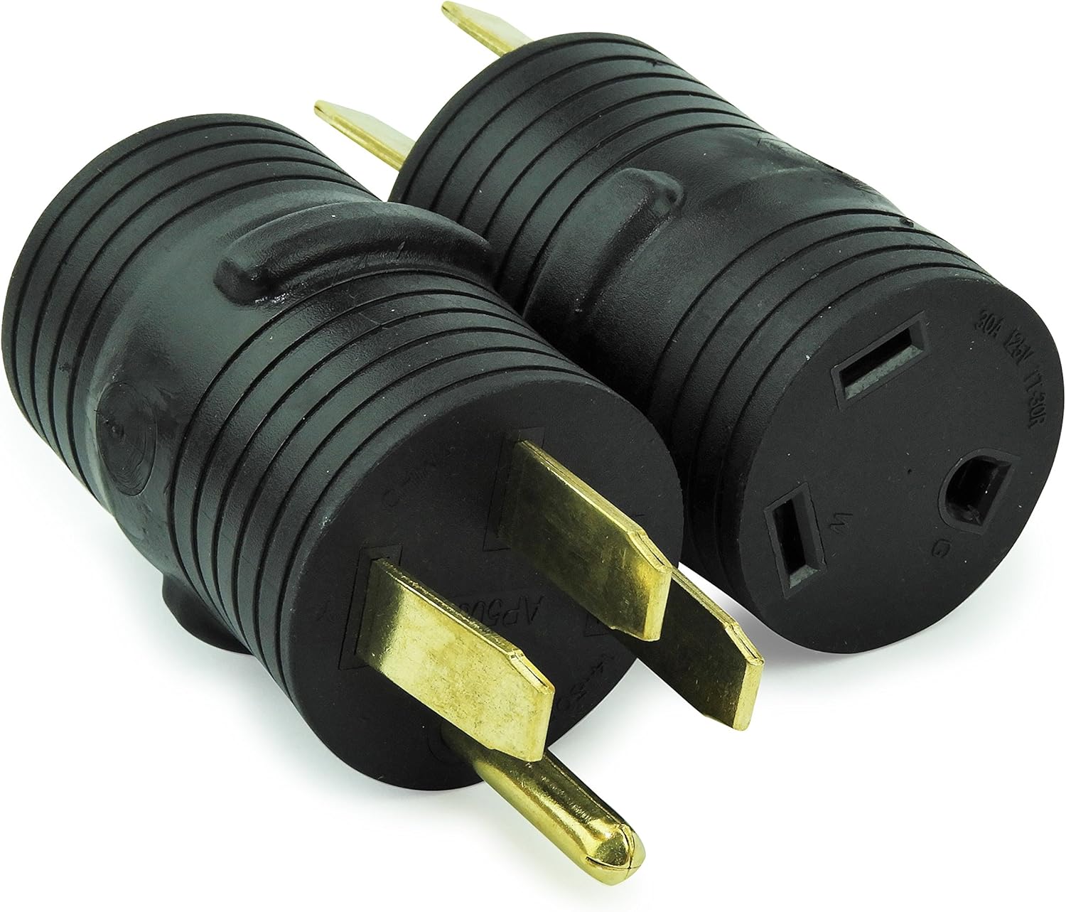

I have one of these in my 'Shore Power' box -
In the original post, a ""50/30 drop down attachment"" was referenced. Am I correct in thinking this is referring to this item or the dogbone style?
The 'dogbone' style is MUCH better IMO, it avoids the height of the stacked adapter/cord pulling out due to gravity. But I carry this one as an emergency use item for when I might not have packed the 'Power Distribution Toolbox'.
This adapter, (and the dogbone style), are internally wired differently than shown in the diagram. (My artwork is not as good as DonC13's, I am a hack using MS Paint  (exactly) )
This gives you 120V, 50A service to the camper. The wiring of the adapter can be easily checked with a continuity meter to prove this, both the adapter and meter are on my desk now.  :lol  I wanted to be SURE before giving electrical advice!! .
 The female side is a Nema TT-30R, which is only rated for 30A, but the supply from the 50A outlet in the post is rated and supplies 50A, so it will deliver 50A to the shore power cable. Which as I originally stated, is the only advantage to using a 50 to 30 adapter.
