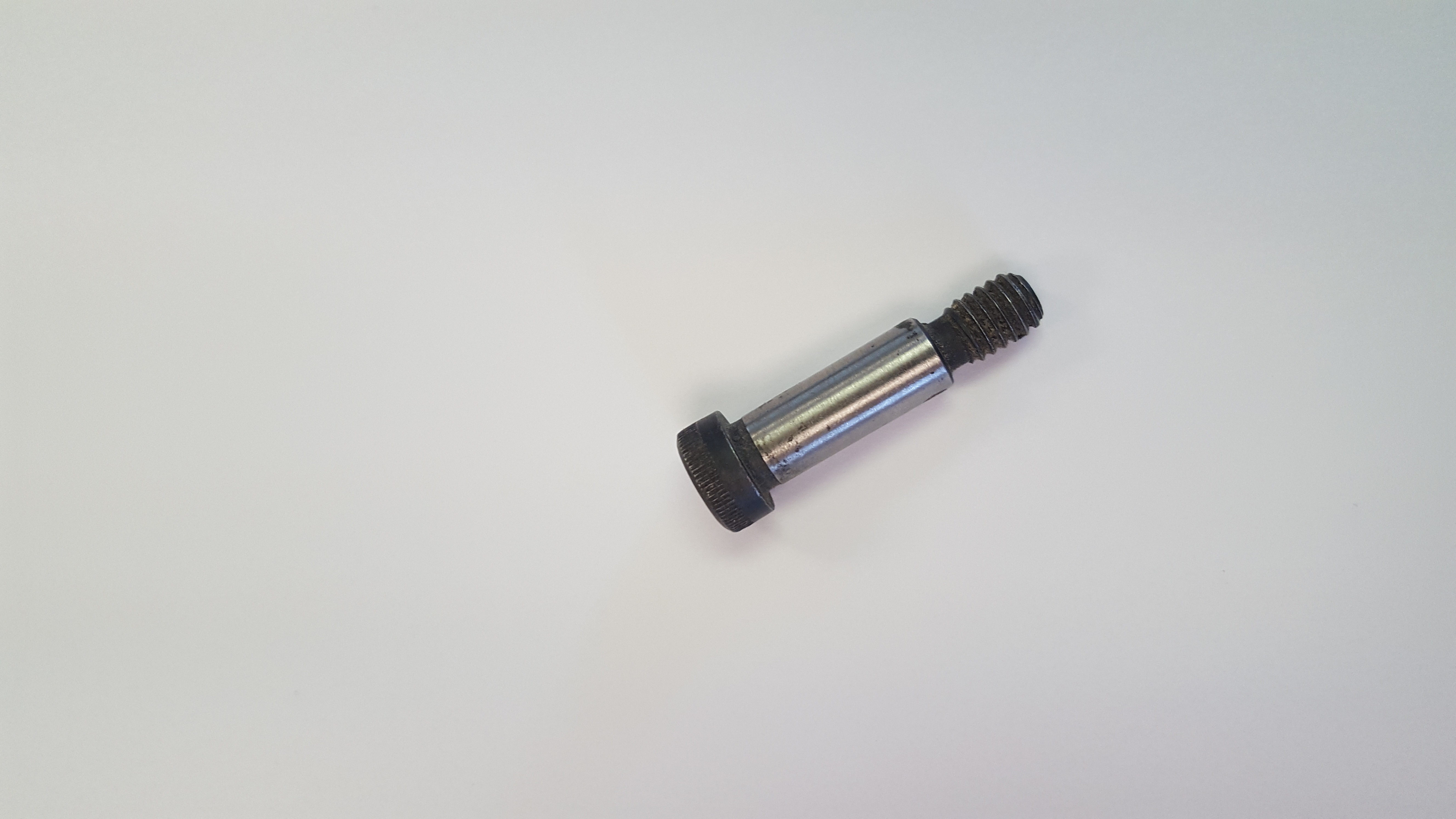

These are similar bolts, called 'shoulder bolts'.  as you see, there is a threaded section for attachment, and an area for load bearing. 'broad shoulders' if you will. If yours are loose, the taller one should easily wiggle. It would be unusual for there to be much more thread to even have it be that loose, i am TOTALLY GUESSING with no pics, but I wonder if a shorter bolt was put in during assembly. Or longer.... here is the replacement part listed for it, 4 ea per ass'y - (source - https://www.liftcoproducts.com/slide-out-parts-elkhart-in?page=2)
3/8 x 1, SHOULDER BOLT , SOCKET HEAD (set of 4 )
We know that the ones we have are longer... by right around an inch... wonder if they were changed at the factory to accommodate a build difference.
Thinking on it, I wonder if the nuts holding the bolts are under the bottom of the slide, but not underneath the coach. In that little 'tunnel' left when the slide is opened. On mine, you can see the end behind the drivers seat. Need a light and mirror to see.. might get ambitious and see.

Yes, that is the bolt. It does appear that they are designed to not screw down flush to the base of the T-block, but I'd like that verified by the builder or manufacturer. I looked online for an installation manual for the slide-out without success. I've sent messages to PC and Liftco asking them if having the shoulder bolt heads above the T-block is normal and will post any response I get. Given the current virus shut-down everywhere, I'll be surprised if I get an answer any time soon.

I suspect those shoulder screws act as guide pins that allow the pillow block bearings to float up and down,  and also to tilt  along the axis to keep the screw drives  parallel to the bottom of the slide room.  The entire slide room box is suspended from the top by  pivoting arms attached to the sides, and it articulates slightly from level as it moves in and out. When I extend my slide room it tilts up maybe 10 degrees after making initial contact with the sidewall,  just before the clutch slips. It’s a much simpler and more forgiving design than the  newer 4 track Schwintek  mechanism.
I came to a similar conclusion after putting the slide in and out and watching the change. Cant see too much due to space constraints. Thought about putting one of my small cameras in there and filming the process. Might if I get really interested, but otherwise I think the shoulder bolts are installed correctly and doing their job. Not too sure about the mismatched heights that the OP has, thinking that someone at the factory had to use the stock 1" bolt for unknown reasons, and got away with it until now.
