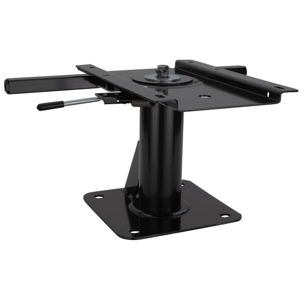

Above is a typical seat base, with seat belt bar in the back. If this looks similar to your seatbase, it is easy to find whats gumming things up. Taking off the 4 bolts (or nuts) that hold the seat to the base will leave you with the pedestal bolted to the floor, and looking similar to the pic above.
Inside is something that looks similar to this:
and that is the swivel. Repair kits are available for many, here is the link to the one above:  http://www.glastop.com/rv-furniture-detail.asp?id=710
If you are mechanically inclined, often you can disassemble the base, clean clean clean and oil, and have them work well. Depends on the cause...if the balls rusted away, well, might not work so well. If it was just dirt, dust and 'crud' hampering operation, then you might be VERY happy with results of an afternoon s work.  2o2
IF your base looks nothing like that... send pics.  (exactly)

Volkeman, FYI - the Eurochair is a free standing recliner. No seat belt. No bolting to floor. Not a vehicle seat. It has a round wooden base with a metal base ring that it pivots on.
 :beg Wow. Sorry, had no idea.    tymote
Like this?
Thats 'only' 50 pounds... using this calculator (https://www.omnicalculator.com/physics/car-crash-force) a 50 pound chair at 60 mph will impart .. 45,000+ ft/lb's of force, or the equivalent of being hit by a 22 TON object.   (chart at bottom, cant put them inline here)
So there is a free standing full size chair with attached base that is totally unsecured during over the road travel?!?!?  :help   Surely there must be some way it fastens down for travel... PLEASE.

Yes Volkemon, the Euro chair clamps down to the floor for when the PC is being driven.  It's just not rated for a seat belt and occupant when being driven.
The Euro chair came out around 2010, replacing the bolted-down pedestal-mounted barrel chair with seat belt.
I replaced our low-back barrel chair with a 3rd captain chair, working with the original pedestal.  It is similar to the one you pictured up higher in this thread.  My pedestal has two levers, one for swivel, one for sliding.  The square tube in back is where the seat belt attaches.
