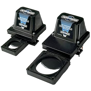

Just to clarify one thing, there are no separate electric or manual valves.  There is ONLY a set of manual valves that have an electric actuator attached to them.  If you want you can quite easily remove the electric actuator and the valve remains in place and will function manually.
There is ALSO a single manual valve that is used with the 4" 'slinky' hose if you go that route.  I did not check completely but I believe in order to use the slinky you would open the large manual valve to by pass the macerator and then use the black and grey valves to dump the tanks.  This is all covered in one of Earl's videos I think.
I recently experienced a jam on my black tank valve that required me to disassemble the whole valve to clear the jam.  That's how I know how easy it is to take off the electric actuator.  :-D
So bottom line:  if you hate the electric actuators they can be disconnected and the valves used manually.  However, (at least on my 2552) that will require crawling underneath the truck to open the black valve.  Personally I will just use the nice little electric buttons they gave us.  And if it breaks, I'll fix it.
Note that the only issue I have had was with the manual part of the valve, the electric part worked just fine.

Hi jatrax,
When removing the electric actuator portion, is there a "T" handle to move the valve manually?  Or do you require a pliers or other tool to move it manually?  It has been a number of years since I looked under our 11 year old PC during the open/close operation.  In my head I recall seeing a "T" handle moving, but I might have recalled it all wrong.  What has me a bit confused about the electro-mechanical tank valve, are the ones I find for sale on the internet.
Here is a typical mechanical tank valve with "T" handle.
Here is an electrically actuated tank valve without a "T" handle.
I did find what looks like an electronic actuator attached to a mechanical valve.
Do we have something like this?
