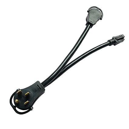

Imagine if you will... the adapter below -
But with small (2x4x2) accessible boxes inline with the 30 and 15 amp outlets.*  Inside each of the boxes are the appropriate breaker (15A or 30A) feeding that outlet. I am thinking small screw cover watertight boxes, as HOPEFULLY one doesnt need to reset the breakers on a regular basis.  :-D  This would be a simple and SAFE way to use a 50A adapter, and have a current protected 30A and 15A service from it.  The shore power cable, the outlet on the coach, the internal wiring, transfer switch and the supply line to the coach breaker box are now all protected properly by a 30A breaker, not a 50. The additional 15A, be it a 'cord through the window' or other configuration, is now protected by a 15A breaker, not a 50A breaker.
Aside from a minor weight gain of the adapter, I dont see a down side to this. I do see benefits.
The holiday season has me a bit slow on my projects right now, but I plan on getting the adapter, boxes and breakers soon.
As always, corrections welcome!! Please.
* Hm... maybe just one bigger box with both breakers. Might be easier to work with. As usual, at work thinking about camper projects.  roflol
