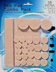

As soon as I left the PC plant with my new RV, I noticed a constant and annoying squeak/rattle noise. I finally tracked it down to the TV over my head ( which now has a bracket that allows moving the TV around for different viewing angles). I wadded up a paper towel and stuffed it between the bottom edge of the TV and the wall that the TV is mounted to. This stopped the squeak/rattle -- but I need to come up with a more eloquent solution:)
Hi,
I am not trying to defend Phoenix on the squeaky TV issue.  I simply wanted to say that you will find in every brand of motor home (PC's included), they rattle in so many places.  If you can resolve the rattle with a stick-on felt pad like the ones I show here, I would place it in the category of "Normal Expectations".  Now if you have something abnormal going on, that would surely be a different story.
I suggest you buy a package of felt pads and use them about your cabin.  I and many others like me did with great success.
Ron
These generally come in two popular colors.  Dark brown is the other.
« Last Edit: December 15, 2016, 01:20:11 pm by ron.dittmer »

Thanks Ron for the felt pad suggestion.
I had also been thinking about trying adhesive backed foam strips that you can buy for weather stripping.
I will have to experiment with different thicknesses of cushioning material to see what works.
