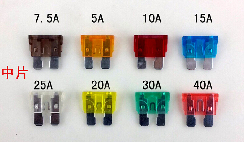

Dale and Cindy,
Since you don't know which fuse supports the sofa bed, I advise you check every fuse, one at a time.  Use a small pliers like this to remove each fuse and inspect it to see if it is blown (burnt and/or broken inside).
If the metal material inside the fuse is not broken, immediately place it back into the same exact socket.  Don't mix the various colors up.  Make sure the same amperage goes back into the same socket.
You are inspecting for a blown fuse as shown below.  A blown fuse should be replaced with another of the same amperage.  Fuses can be purchased at any automotive store and at places like Walmart in their automotive department.
  If the new fuse of the same amperage (same number) burns again immediately, temporarily replace it with the next number larger.  You want to get the sofa open to inspect everything the other helpers here have mentioned.  If you find something suspicious and can resolve it, then replace the new higher amp fuse with the same number as the original.
