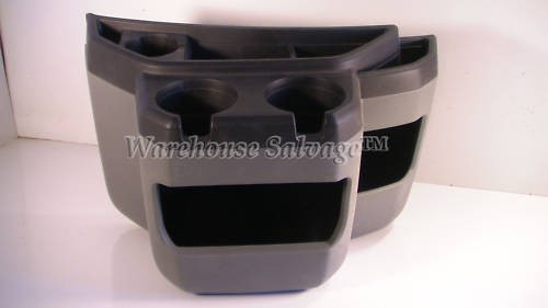

BTW: The latest 2009-2012 Ford center console snaps right onto your engine cover.  It offers lots more storage.

Is that a Ford item or a PC item?
That would be a "Ford" item.  Ford E-Series center consoles (the snap-on cup holder thing) are interchangable from the middle 90s thru to today.  They are gray with black plastic tops.  They have 5 top bins, two large front-load bins, and also holds 2 cups.  I believe the people who are selling them, got them from places like ambulance companies who toss them as part of the retro-fitting process.
They are sold on ebay:  Click Here To See One For $45 With Shipping
I have one that if you were close to me (West Dundee, IL) I'd sell it to you for $30.  I was planning to paint it the color of my brown-ish center console, then send it to a shop for the wood grain, but decided against it due to excessive costs.  When it fit my brother's 1998 E350 motor home I then offered it to him as a Christmas present, but his wife didn't like it because with their old fat/wide driver seat with power seat controls inboard, there was not enough room to get her legs past without lifting over the driver seat.  Passenger seat was still fine.
