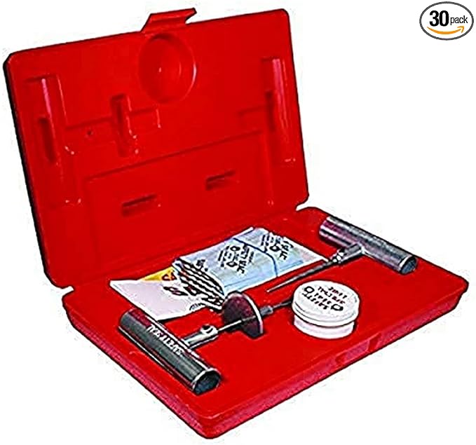

IF you are serious about carrying a tire plug kit, especially for LT (Light Truck)  series tires, dont waste the space carrying the cheap stuff. This is a good LOOKING kit, and very reasonably priced. ~$20.
https://www.amazon.com/Tooluxe-50002L-Universal-Punctures-Motorcycles/dp/B002I52RG0?th=1
Here is the best kit IMO.   Twice the money and more. ~$45  I have had one of these for years. Dumped the plastic box, keep it all in a small Tupperware container.
https://www.amazon.com/Safety-Seal-KAP30-String-Storage/dp/B001DIECCK/ref=asc_df_B001DIECCK
I have put in hundreds of tire plugs. Safety seal/ North Shore Lab plugs are THE ONLY ones I trust now. They do not dry out. They do not 'work' their way out. Double them up for the HUGE 'Plug cant fix that' holes. Removed a 2" long 5/16" bolt (!!) from the fertilizer truck tire. Big 24" truck tire. Used two plugs.  It held, and passed a bubble test at 100PSI.
My experience... skinny black tire plugs are the worst. Spit out like a watermelon seed even when used in golf cart tires at 22 PSI.  Orange and fatter can be better, but suspect.  IF its for YOU, Safety Seal/North Shore Labs. Cry ONCE.
Little hint on installation:  Use the lube.  And also add several razor blades in the kit.
https://www.amazon.com/Single-Industrial-Razor-Blades-REXBETI/dp/B07GJ88YVV/ref=asc_df_B07GJ88YVV
Some come in little envelopes like this, others in cardboard sleeves. Soak them with some WD-40, and put 10 or so in a baggie.  After installing the plug, trim the 'tails' sticking out so they are flush to the tread.  This will ensure a repair that lasts.  2o2
If you carry a plug kit for emergencies, make it a good one before you add another emergency to an already lousy situation.  (exactly) Even if its not your hand injured, what will you do with a broken plastic handle in one hand, and the steel shaft poking out of your tire?
