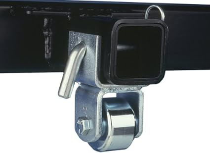

Looks like I will have to customize my ball-mount to take a skid plate.  The nut to the ball sits ~5" lower than the cross rail that most of these kits bolt/weld to.
I have done a few searches, and cant seem to find anything that works as a skid plate AND uses the ball at the same time. Just things similar to this:
I found one that has a single wheel, but still will be above ground level when the ball nut is dragging:
Looks like maybe a 4" drop insert with a welded ball, then make a flat plate... dunno. Open for ideas, I cant be the first one to be in this spot.  :)(:

I found it interesting to see the Ultra-Fab skid wheel package 48-979017 mounted two ways.
This picture on Camping World's ad.  I think this is dead wrong.
This picture on Ultra-Fab's website.  I will be installing it this way.
Maybe you do it the wrong way if your hitch is less than 2-1/2" stock.
« Last Edit: December 30, 2020, 09:56:25 am by Ron Dittmer »
I think you found a marketing error when they assembled it for the picture.  Good catch. I bet the instructions dont show that.
OK, being me I had to see.   (exactly)  They dont.  :lol https://ultra-fab.com/wp-content/uploads/2018/07/48-979018-install-inst.pdf

I just got the Ultra Fab casters. The instructions included shows the metal plate on the bottom, the caster side. I will be installing when it stops raining and warms up a little.

As mentioned above, I have installed the ultrafab  wheels.  They are spaced out L/R as far as they will go.  However , even with them I have dragged off what appears to be an extension to the backup sewer drain in the far back corner.  No real damage except breaking the ears that connects it.  Can live without it.  Now said, if the wheels could be lowered, would give a bit more
“Lift” when needed.  Just looking at it out in the rain, there are still several threads left on the U bolts.  So I’m going to take off the nuts, add some large flat washers and lower the wheels as far as the ubolt  will allow.  Any little bit will have to help.

My purchase came in today.
For you with PC's as old as our 2007 with 5000 pound hitch, this kit fits.  I snuggly slipped one of the "U" bolts over my hitch bar, confirming I have a 2.25" dimensional bar as the rollers are designed for.  I will be mounting this kit to our 2007 2350 in the spring.

There is definitely some confusion on the actual dimension of this bolt-on roller unit.
In your earlier post with the link to the E-trailer site for this item, you referenced the Ultra-Fab product UF48-979017.  Both on the E-trailer site AND the Ultra-Fab website, the UF48-979017 is listed to fit a 2 1/2" crossbar.  As a matter of fact, the Ultra-Fab website only lists two roller kits of this specific design--the 979017 fits a 2 1/2" bar and the 979018 fits a 3" bar.  There is no listing for a 2 1/4" bar.
A search on the UF48-979017 part number brings up several different vendor sales advertisements for it---some of those ads do reference fitting 2 1/4" square tubing, and some reference 2 1/2".  The set Ron purchased on eBay plainly says for 2 1/4" bars in his photo.  However, on today's listing for UF48-979017 on Amazon I saw one question and one comment referencing the need to insert a spacer on the 2 1/4" bars to shim out since the kit is designed for 2 1/2" bars.
Finally, my crossbar on my 2019 2552 is 2 1/2" (double-checked), and has this unit installed.  Since current descriptions for UF48-979017 on E-trailer, Amazon, and Ultra-Fab sites currently specify 2 1/2",  and Ultra-Fab doesn't even currently list a 2 1/4" unit, I think you would safely receive one that will fit your hitch if you order from one of these sites.  This is definitely something that bears careful scrutiny from anyone interested in this modification, however.
