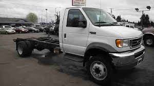

I wish there was an E550 so to speak to handle the larger C class.
There once was an E550.  I think Ford made it for two years, 2003-2004.  It might have been a class A type chassis with the full front axle, huge tires, a lot more capability, and the van cab like the E450.  Here is a picture of one.  I don't know if any motor home manufactures utilized it.
