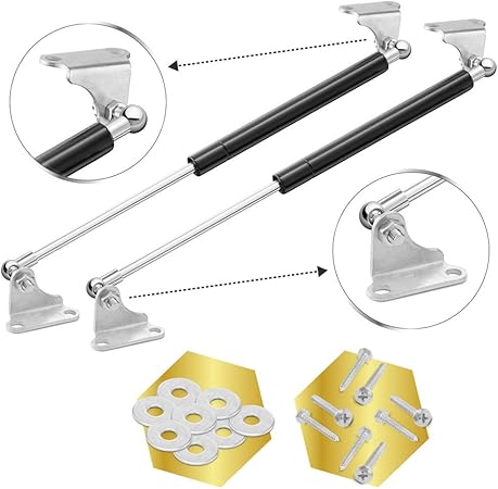

The gas strut assemblies are the things that keep the door from closing. They consist of a strut, charged with gas pressure and they work like a spring. This does the lifting. There are two mounting brackets at the end, generally with ball ends to allow freedom of movement. An example of the assembly is below:
Guessing you mean the mounting points for the gas support struts pulled out / broke off? Thats what happened with one of mine, the screws pulled out and the upper bracket was no longer attached to the door. Upper bracket was similar to what this person has cradled in their hand:
The screws were anchored in the thin sheet metal that was over the foam core of the door, and pulled out.
Lucky for me, the other one still holds, and I dont use that hatch much. But when I do fix that area, I plan on removing the door,  taking off the inner skin and replacing foam with wood in the area where the struts mount. This will give a firm anchor for the screws, unlike the thin metal and foam.

The gas strut assemblies that keep the door from closing are charged with  pressure and they work like a prop when extended.  There are two mounting brackets.  One at each corner, generally with ball ends firmly mounted in the door frame structure.
On my Phoenix Cruiser, the upper brackets  for the gas support struts pulled out from the mounting points.   The screws pulled out from the very thin plastic supporting the upper bracket.  The screws were anchored (?) in the thin sheet plastic that is the core of the door.
 I don't use that hatch much. One side continues to hold and supports the door.   I have tried to fix  the affected area by simple procedures.  Such as using larger diameter screws.  When that fix didn't last, I tried using plugs as hollow wall anchors.  That definitely didn't work.
As a permanent repair, I am planning to open an aperture into the thin inner skin and gluing a custom fitted wood block in the area where the struts mount. This will give a firm anchor for the screws,  Unlike the thin plastic.
There is no depth to the space between the inner liner and outer door panel.  Short screws will have to be used.  Even considering that, a half inch of wood will hold considerably tighter and longer than a sixteenth of plastic.

I had a strut break off because of the flimsy surface it was screwed into as others have described.  I simply cleaned with alcohol both the door and the strut  plate where the two met, covered the bottom of the strut plate with a piece of 3M VHB tape, then used  larger diameter sheet metal screws to reinforce the VHB.   That was probably five years ago and has never been a problem again.   That tape will hold almost anything if you clean properly and the two larger diameter short screws reduce the strain on the tape.   Whole procedure takes less than ten minutes.

See below image, $8 and just as good

I can imagine the two-sided tape being a more practical solution than custom fitting a wood insert.  The link you forwarded offers a much more affordable source.
Once the tape arrives, I am going to use it on both struts.  The side needing repair demonstrates how feeble the factory installation is.  And, my first repair attempt which was to use larger diameter screws proved to be equally short lived.
Reinforcing the side that remains intact seems like a sensible precaution.  Otherwise, I predict the probability of it ripping out of the  thin plastic as "inevitable".
