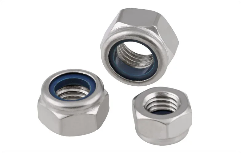

Cal, is there enough threaded length to accommodate a nylon lock nut?  They are sold in stainless steel at most home improvement centers.
