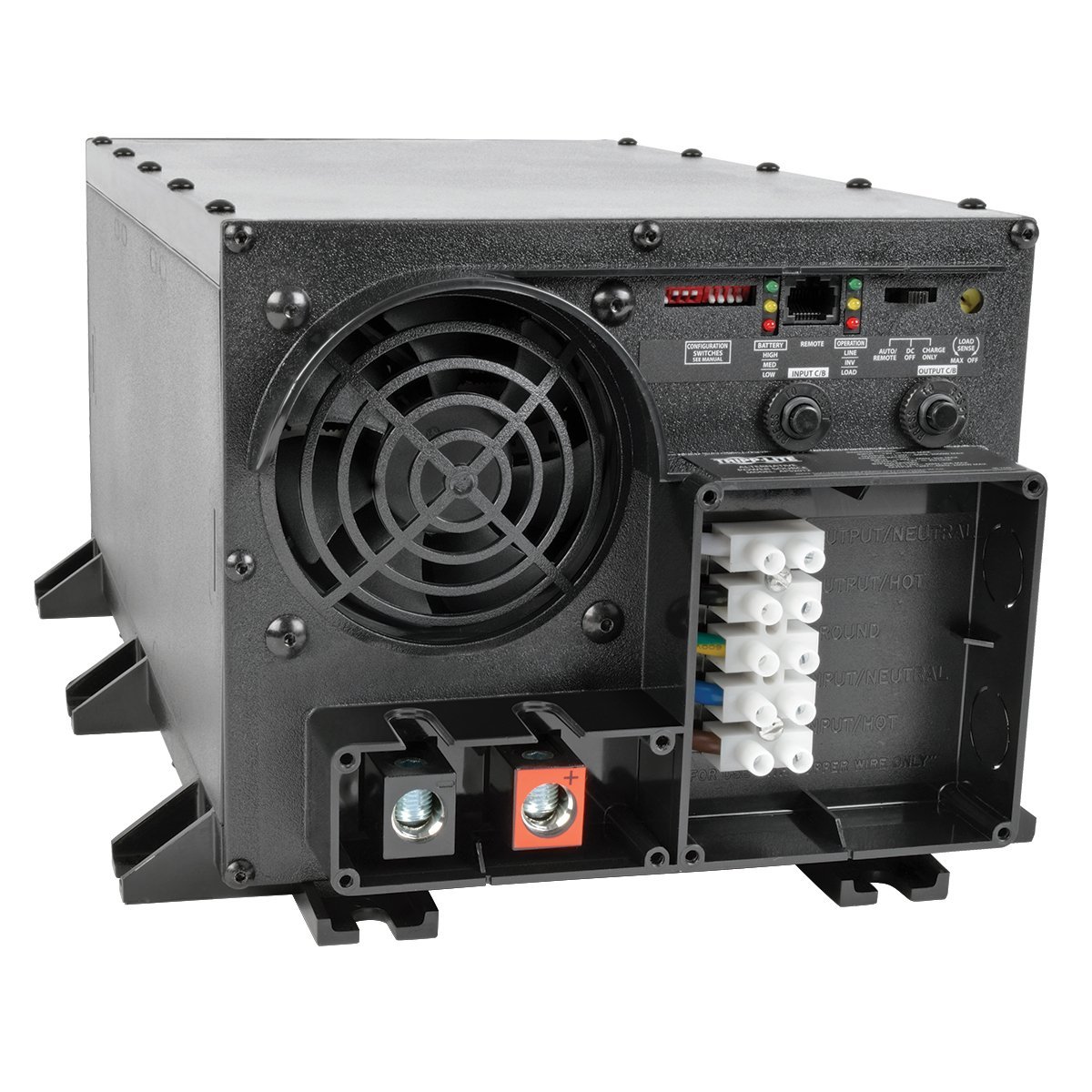

I'm all stock with my 2006 2700, one battery, and wondering about doing the 2 AGM  change-over, and if it will be sufficiently charged as is, or will need modifying.
jim
Hi Jim,
I am not familiar with your particular 2006 model year on-board battery charger.  But when changing to AGM technology, chargers sold 10-15 years ago need to be configured for AGM.  It usually is done by relocating a jumper or reconfiguring switches on the charger.  If you don't have the manual for your charger, look for the model number on it, google it, and find the user/operation manual on-line for it.  In the document, it would be very clear if your charger can handle AGM batteries, and if so, how to make the adjustment.  On my 2007 Tripp-Lite, the change took a half hour to find & read up on it, and a few seconds to reconfigure the switches.
In this picture of a Tripp-Lite, the switches are red and white, located just left of the green/yellow/red LEDs.
