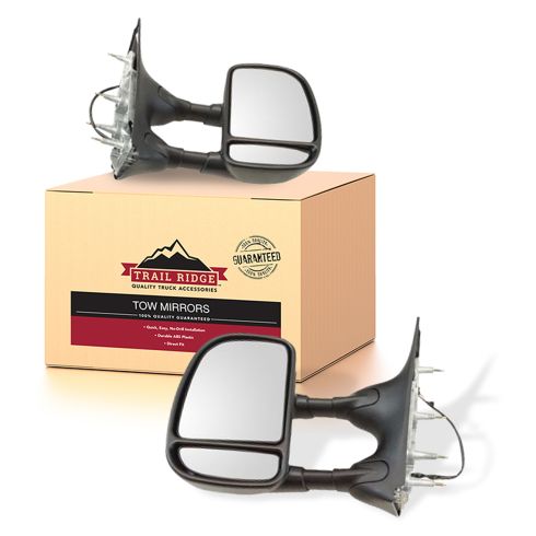

My mirrors are also yellowed or maybe they were yellow at birth.  The ad  you posted shows out of stock.  I wonder if the function of mirrors is the same as when my 2006 comes with.  If so, is it hard to paint them black or some other color?  The yellowed ones work fine but I would like it to look nicer.
On mine all the functions except mirror heaters are there. Quick google shows them here - https://www.1aauto.com/ford-mirror-set/i/1amrp01962?f=1241341&y=2006&utm_campaign=gb_csv_br&utm_content=MRP&gclid=CjwKCAiAj-_xBRBjEiwAmRbqYrwgHL3knJuPi2JCAFBa-gu4IwV80kNQD929bYAvxNtjhDB5_PXVVhoCzM0QAvD_BwE
They DO NOT offer the same visibility on the right hand side as the larger mirrors. I willingly accept that for the (IMO) better look.
I like the bottom element being separate, i keep it pointed low and it is GREAT for seeing the road lines and keeping centered in my lane.

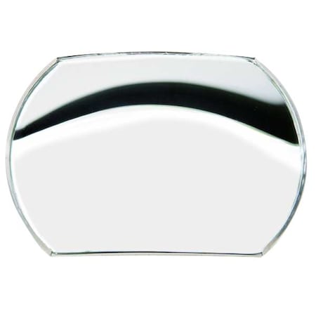

I wish there was a convex glass available for the right top element, but I have yet to find one. That would put them back up 'on par' with the big mirrors that were on there.
I put one of these mirrors on it, works well. Gives a similar field of view as the big ones now.
https://www.zoro.com/velvac-stick-on-mirror-convex-723075/i/G2214107/feature-product?gclid=CjwKCAiAj-_xBRBjEiwAmRbqYtJioZGzFZhQyZMyVmQ7jfgoX9-Ja6BFcoqFRy2Q_U5ilYnA0PkBiBoC1_gQAvD_BwE
If I were to paint the 'stock' mirrors, it is easy enough to take them off the door. Inside panel has a screw holding it, then (4) 10mm head nuts. It allows you to see any corrosion behind the door mount as mine had hidden.  (nod)   Overspray would not be an issue either.  2o2
