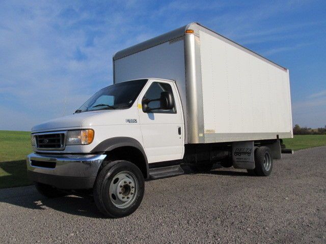

The 2003(?)  E550 bumper looks cool. I didnt even know there WAS a E550. Evidently pretty rare.
Wikipedia - ""For 2002, a heavy-duty E-550 variant was introduced. Sharing chassis components with the Super Duty, the E-550 was distinguished by a grille styled in line with Super Duty pickup trucks (with a three horizontal slots between two vertical openings). In addition, the heavier-duty front axle required the use of a larger front bumper and plastic fender flares (shared with the F-550 truck). Depending on trim, E-550s were fitted with either chrome grilles, chrome bumpers, and flush headlamps, or gray plastic grilles, bumpers, and sealed-beam headlamps. After the 2003 model year, the E-550 was discontinued.""
 Read down in this link - https://www.ford-trucks.com/forums/1369566-ford-e550-production-years.html   Someone wants to beef up their C class to 19K GVWR   ;)
I am not sure if the bumper is TOO wide... but would look SO factory awesome. The PC flares are pretty wide, so might mate up well.  Looking for the bumper now, the flares are shared with the F550 of that era. The bumper appears to be unique...  >(

BTW: The E550 front bumper appears to protrude much further out the sides to align with larger E550 fender flairs.  Then you'll be replacing your fender flairs with E550s, then your wheels to match the fender flairs.....seemingly no end to that one.
« Last Edit: August 04, 2019, 10:01:44 pm by Ron Dittmer »
And indeed, I finally found a 'head on' pic of the E550, and those flares stick out about 4" per side, compared to the ~2" of the flares that are on there. No biggie, as it looks like that bumper is made of 'Unobtanium' anyway... I have yet to find a listing for it 'in stock'. MANY just say that the E150-E550 share the same bumper.  >(
