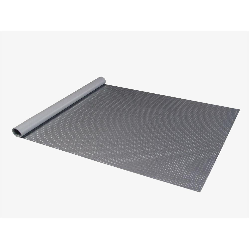

So... after *actually looking closely*  :lol  at the front floor, I realized that it is going to be easier than I thought.  (cheer) (cheer) (cheer)
I am going to leave the original glued in carpet for noise and heat control. May put a radiant barrier above it for a little more heat control. and because I happen to have a roll to use.
The step wells on my cab are black plastic.  2o2  AND they cover the edge well. And there are only simple bends, no compound curves (ie:bowl shape) except for the very top under the pedals/forward of the passenger feet.  2o2
So I am topping it with this -
https://www.homedepot.com/p/Diamond-Deck-5-ft-x-9-ft-Battleship-Gray-Golf-Cart-Mat-82059/206315010?cm_mmc=Shopping%7cTHD%7cG%7c0%7cG-Pro-PLA%7c&gclid=EAIaIQobChMIrbOGl83c2AIVT57ACh2ykQ5ZEAQYAiABEgJVQ_D_BwE&gclsrc=aw.ds&dclid=CMPqlZzN3NgCFcQPgQods4AA-Q
""Great for workshops, basements, trailers, laundry rooms, mud rooms, bathrooms, toy haulers, motor-homes and camping. Perfect whether you need a temporary or a permanent flooring solution that is tough, waterproof, durable and easy to install.""
YEAH BABY!!!
1/8 thick PVC. The areas in the front that have the slight compound curve can be easily formed with a heat gun and sandbag. IF needed, I can even solvent-weld it. Not to mention its about 12% the cost of the Ford rubber mat AND tougher. Will look tough also. Even matches the grey of the dash.
May need to 'shave' the carpet fibers off around the edges to get a good fit, but otherwise looks like a WINNER.
