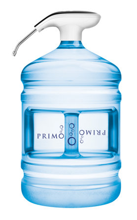

Not the smallest of installs, but has good storage beneath and is nice and 'out of the way' in our 2350.  Held in place with the strap, 1500# breaking strength.
No plumbing mods or filters needed either.  (cheer)  The water dispenser we use is rechargeable from a USB cable.
https://www.wayfair.com/Primo-Water--Countertop-Electric-Water-Cooler-601244-L982-K~OCKQ1001.html
 Shown with slide out.
Slide in -
Holds 10 gallons, is easy to remove one or both jugs and fill them in WalMart or other trusted potable water source.
Easy to remove jugs to clean and sterilize.  Easy to remove the entire unit also, if desired. Leaves nothing but 2 eye bolts in the floor. Should a day come that we sell, I can remove everything and put 2 carriage bolts in the floor if the unit is distasteful to potential owners.
I do NOT trust our water system in the camper for drinking. Period. (Bathing, commode and sinks - SURE!!) This was the best option I came up with. We refill 1 Qt water bottles from it and keep them in the fridge.
Makes for a great place to keep our shoes now also.  2o2  When we are camping, we tend to use 1-2 gallons of drinking/cooking water a day. More if its Florida summer camping.  :)(:
