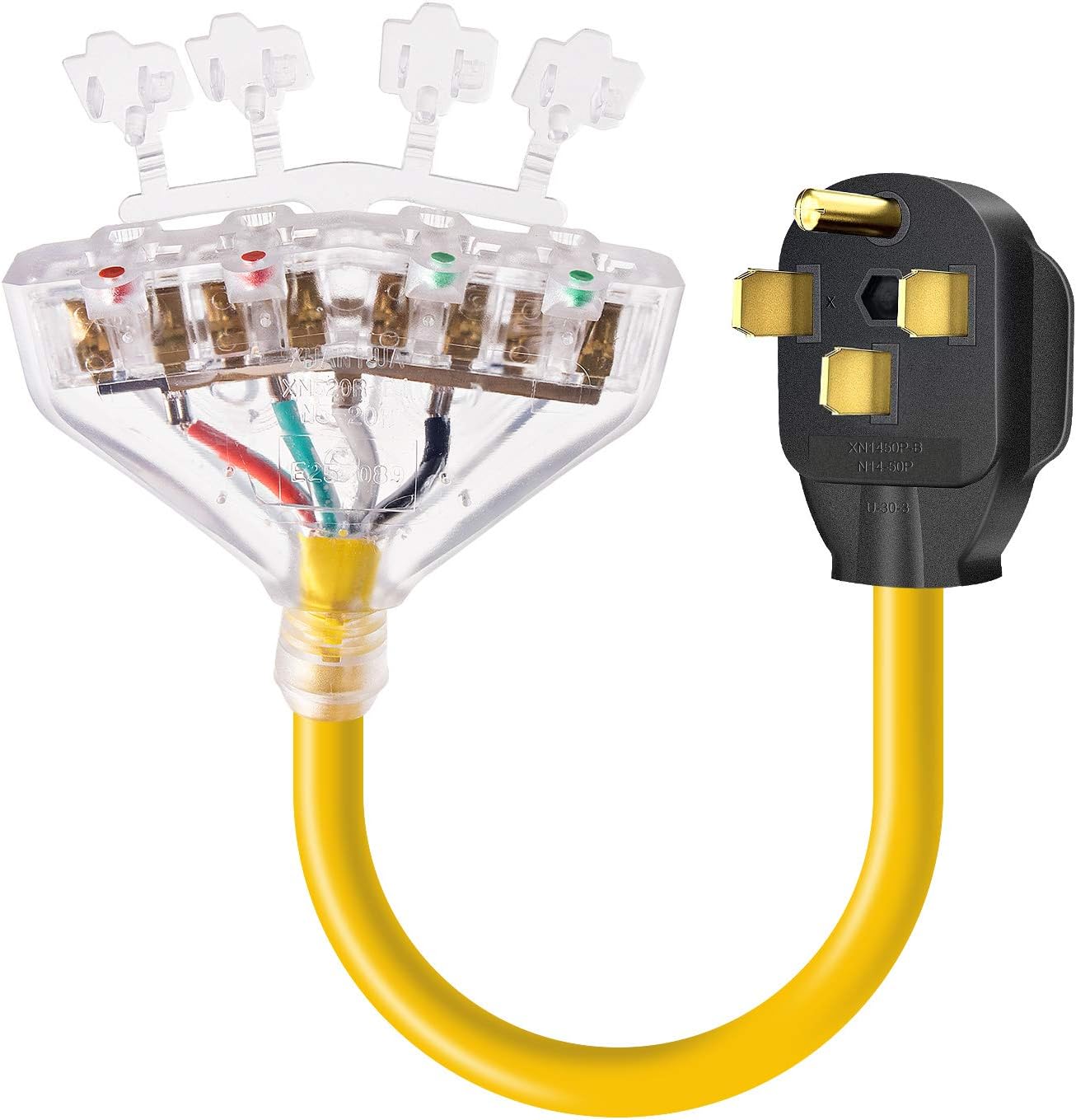

Wow!  I would have thought the same. It does state in the questions and review that it does not, however. I feel a little better about my setup not having fuses...check out this wonder..
https://www.amazon.com/dp/B08NXHHCKG
""10 AWG all-copper wires,""
So no fuses/ breakers, and it will roast all the way back to the 50A plug.  :lol  at least they use both legs.  2o2   It may look hokey, but I like my little 'Powerbox' more and more.

Volkemon, your "wonder" 50 to 20 posted above is the first commercial one using both hot legs.  Just a few bucks more ($8), but you can CLEARLY see the hot leg #1 Black and the hot leg #2 Red thru the resin composite.  You can also see the common White bus that connects all the 20 amp receptacles.  Very cool find!
"So no fuses/ breakers, and it will roast all the way back to the 50A plug."  Where do you see the weak point in this.  Are you thinking there may be an internal short in the clear resin, or are you thinking someone may try drawing many amps thru one 20amp plug?
I agree Volkemon, your 30amp setup does look safer....
However, here is another choice that at least one reviewer claims it does use both legs.  This one is by LeisureCord store. I guess the only way to know is to order one (as I had done above) and check it with a voltmeter to see...
https://www.amazon.com/gp/product/B079NL42ZS/ref=ox_sc_act_title_1?smid=AIVNKK5E0ABND&psc=1

Note how the NEW adapter you found (  https://www.amazon.com/gp/product/B079NL42ZS  )  has 10Ga to the junction, then says it has 6Ga to the 50A plug. My box is the same way....the 10Ga wire inside should toast before the 6Ga does damage. So the damage is in the box. (NO testing to confirm, hope I never conduct one!  roflol )
The 50A to (4) 20A outlets says it is all 10Ga to the 50A plug. So the 'hot wire' doesnt stop in the junction (in the adapters case), or in the box (in my case) . It will fry all the way up to the plug.
Really not a substantial difference, more an observation. Again, not gonna test.  2o2   Just 'Bench Racing' as they say.  :)(:

""However, here is another choice that at least one Amazon reviewer claims it does use both legs.  This one is by LeisureCord store. I guess the only way to know is to order one (as I had done above) and check it with a voltmeter to see...
https://www.amazon.com/gp/product/B079NL42ZS/ref=ox_sc_act_title_1?smid=AIVNKK5E0ABND&psc=1  ""
My post above HAS been ordered and received.  I took a meter set on continuity and CONFIRMED Leg 1 goes to one 30 amp, and Leg 2 goes to the other 30 amp.  Donc13 states that crossing these 2 will be a huge mistake.  These separate 30 amp legs would be used to serve different circuits and would not be combined.
Leisue Cord in California confirmed by phone that Leg 1 did not serve both 30 amp splitters and thus I felt comfortable ordering it.  From observation, this cord looks well made and is worth the $40.
Volkemon's box suits his needs better as he has more options and standard 110 outlets which is a benefit.
I would like to test my hypothesis when 50 amps are available and I find low voltage on my meter while using the electrical post 30 amp outlet.  I don't want to damage my A.C. trying to run on 105 to 108 volts.  So I will see if Leg 2 of the 50amp provides higher voltage.
