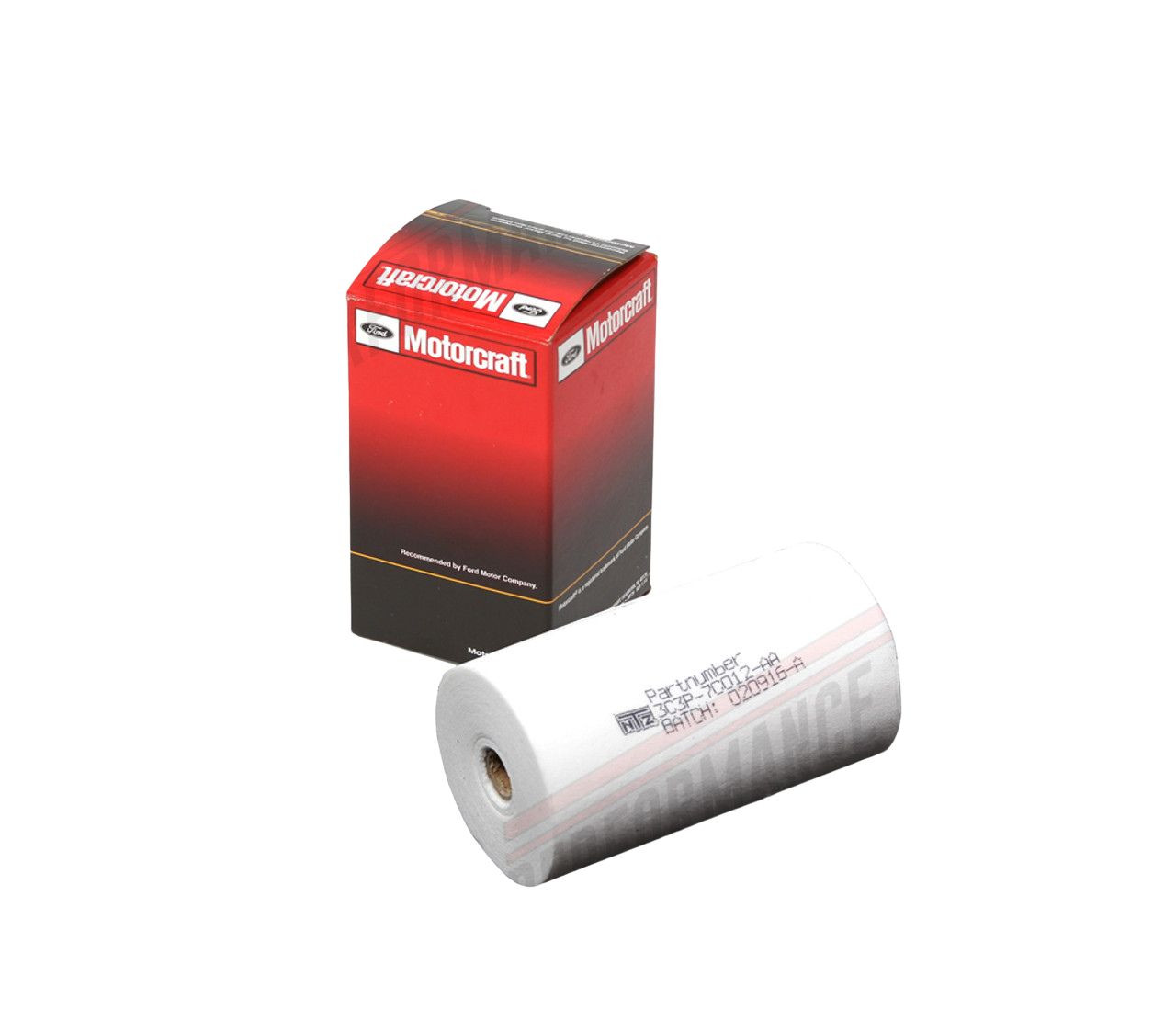

The external secondary bell jar filter is an odd feature that is found only in the 2004 to mid 2008 5-speed TorgShift transmission.  Only a portion of transmission fluid runs through it, and if it becomes 100% clogged, no harm is done to the transmission as the system is then bypassed.  It is an "extra" system solely for "refined" filtering.  The filter in the pan is different too so maybe it does not filter as well as the one that replaced it in the years that followed.
Here is a picture off the internet of the external transmission filter bell jar housing.
This is the filter inside it.  It appears to be a "refining" filter for maintenance of the fluid.
