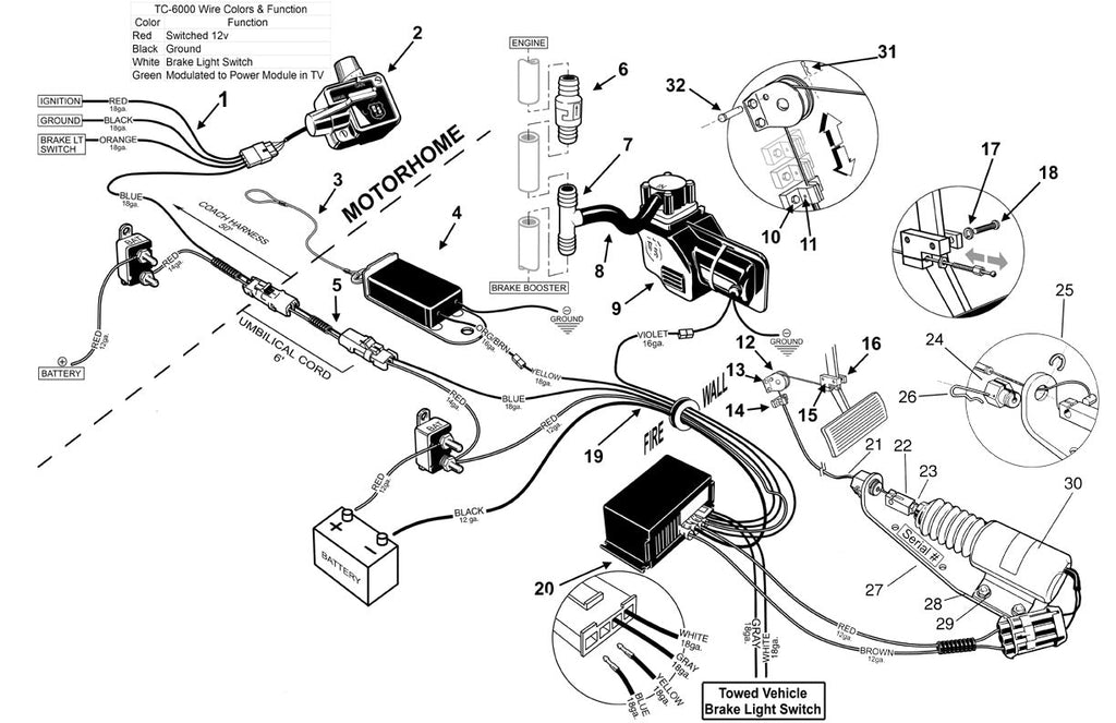

For our Liberty, I bought a Unified By US Gear tow brake that works well.  I believe the system is no longer available for sale today.  Here is the system diagram.  It is fairly complicated, but once installed, is very effective and easy to connect and disable on trips and when back at home.  This braking system continues to work well for us for all these years.  What I really like about this particular tow brake is that the Liberty's brakes contribute so much that the braking distance of the over-all train is noticable shorter.  We brake better and faster when towing than when not towing.  I don't worry about prematurely wearing out our Liberty's brakes as brake jobs on that vehicle are very simple and affordable, especially doing the work myself.
