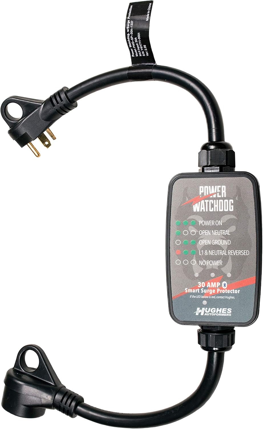

RE: Generator - I use one of these, and couldnt be happier -
https://www.harborfreight.com/3500-watt-super-quiet-inverter-generator-63584.html
Carry it on a receiver mount cargo carrier with a couple cans of gas. MUCH quieter than the onboard when we boondock at festivals. I have one with 350 hours, and a newer one with 40 or so. Love them. Runs Ac just fine, i have frige and water heater on LP. 'Sturgi-stay' kit is handy for this also. I always use the external tank first, and only go to onboard tank for last resort.
You need a voltage readout and current draw reading. Right here is the answer:
https://www.amazon.com/Hughes-Autoformer-PWD30-Power-Protector/dp/B0791RW8M2
I love this item. Shows on my phone how much power (Amps ) is being used. And incoming voltage. It has settled a few arguments over whether I was drawing too much power, OR if the supply was bad. In an instant.

No questions if your wiring is sufficient, and a meter that both protects you and informs you of use and supply rates. You will find power issues 'down the road' will be simple to diagnose.
Good Luck!
Re: 2551 blowing 20 amp circuit
« Reply #8 on: August 28, 2021, 05:43:54 pm »
+1 on the Hughes Power Watchdog. Mine is  still going strong after 4 years.
While you are turning things off to adjust the load you can watch the amps change in real time on your phone. After you are finished using it to calculate how to best manage your power you will still have a excellent surge protector with a high joule rating and replaceable fuse.

I must "me too" on the Power WatchDog!
The watchdog checks the power before it allows a through connection to the RV and will discovery the power of the voltage is too high or too low. This saves me several times a year for damage.
The app on your phone shows the status of the device including voltage, amps and total power consumed since the last reset (which is very useful when you pay a monthly rate and want to audit/double chk the power meter on the post).  I can turn on and off an individual object and see exactly how much it consumes. It will surprise you home much power some sweet and innocent things consume.... I'm looking at you long strings of old fashioned patio lights.
A couples bonus features are  that you will get an alert on your phone if the watchdog loses power for any reason.... brown out, storm, theft, etc.... But this also includes if you become more than 40 ft away from it. (the limits of bluetooth!) The dog face also lights up so you have an automatic night light at the utility post. It's a bit of light pollution, but better than having someone trip over a power cord or water hose at night.
