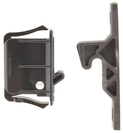

We love our screen door but on the last trip our latch disintegrated.  Essentially, it is a Southco style grabber latch recessed in the door and held by plastic clips at the top and bottom of the latch.
I found what appears to be the exact latch on Amazon from two suppliers, both of which are "out of stock".    Given the special purpose of this style latch, I don't know if it is NOS or the COVID supply chain is a problem.   In any event, I want the screen door fixed before my next trip in about a month.
I bought a magnetic heavy duty latch yesterday at Home Depot and I think I will simply attach the provided steel plate to the edge of the aluminum screen door and the mount the magnet portion appropriately aligned and spaced on the door frame after removing the original Southco receiver hook.
I am sure others have replaced the originals and maybe with original type designs but has anyone used a magnetic catch?
Bear in mind these are not refrigerator magnets.   This baby is strong and the packaging does not give how strong it is, but the model number seems to indicate 7 pounds lifting strength.   In placing the magnet portion on a heavy piece of steel to test it, I certainly think it will hold and if it doesn't I can always use two of them.   If it is too strong, that is an easy problem to rectify by limiting the contact surface.
I searched the forum archives and found some old discussion about finding the replacements five years ago.   Of course, I could always call PC but I would really like to eliminate problem of a plastic catch altogether.

No, Ron my latch is completely different.   Take a look at this:
https://www.amazon.com/Southco-C3-510-Grabber-Catch-Latches/dp/B010O4XOUE/ref=sr_1_8?crid=3L0W6ARSGUVTK&dchild=1&keywords=southco+grabber+latch&qid=1623712310&sprefix=southco+grabber%2Caps%2C187&sr=8-8
That is a 10 pounder and what I need is a five pounder.   I'm afraid ten pounds would be way too much.  The five pound models are not available, even though a few sellers are showing them on Amazon.   I had an order in for two weeks and then Amazon cancelled it because of being out of stock.
I think we have all had experiences with these Southco products and I carry five or six regular Southco latches with me because I know I will replace several over the summer.
The magnets would require modification to the screen door that only consists of two small mounting screws (or even 3M tape) to hold the steel striker plate in place in place.   Also, the existing Southco latch is held on the main PC door frame with a couple of pop rivets so that modification is simple.  Simply replace the existing Southco hook by mounting the magnet in the same vicinity.
I can't find the exact latch I bought on the HD website but here is something similar but less powerful.

Don is correct, it is not a true screen door but I think the term "screen door" generically describes it function.
Ron, as I stated in my original post, the mechanism disintegrated.  It dropped pieces all over the ground, including the spring and bits of plastic so it obviously cannot be rehabilitated.   It is a one way insert in that I suspect once it is in place you will tear the heck out of it getting it back out.   It is, as I stated, about the same as a regular latch except it is clip mounted and not screw mounted.
My question is:  has anyone used a magnetic catch of the appropriate strength for the purpose??

This should be the replacement - the manufacturer of the retractable screen door is Liftco.
https://www.liftcoproducts.com/product-page/liftco-replacement-screen-door-latch

Here is an update to my original post.
I replaced the existing latch with the HD magnetic latch and it works fine.  I just drilled out the pop rivets in the original catch and installed a magnetic catch there and a small steel plate on the screen door itself.   The screen door has always tended to be a bit out of plumb and I put a second latch at the top of screen as well.  This really aligned it correctly.   Not wanting to drill holes for the second latch, I used  3M VHB tape on it and gave it a couple of days to obtain max strength.  I also used the tape to install the small steel plate to the screen door at the top.  The door frame is white and the latches are white and match just fine finish wise.
Actually, I like this setup much better than the original.   It is operationally smoother and I don't have the worry of another plastic part breaking.    Like most of us, we travel with several of the Southco style latches because we know at least one or two will break on a multiweek trip.
