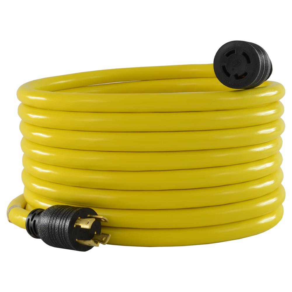

Now We have a safe 30A connection to the RV generator. We have a proper generator transfer panel inside the house. Just have to link them.
https://www.homedepot.com/p/Conntek-50-ft-10-4-STW-30-Amp-125-Volt-250-Volt-4-Prong-L14-30-Transfer-Switch-Cord-Generator-Extension-Cord-20602/309291375
And now you have a 30A backup power circuit in your house that works off your RV.    (cheer)  Cost will depend on your abilities and other parameters the existing building and RV wiring may present.

Adding a plug in line as Mike said is a good idea also, and does make sure you cannot backfeed through the supply.  2o2    I was aiming for a little more inspector-friendly setup.
Curious... I never did any NG burner work, they did not have NG service in our area.  The boiler/heat exchanger uses no or negligible power?  Even in forced air apps?  Being used to oil fired, there was ALWAYS current draw just to make the heat.
The 5 ton AC in our house has a blower rated 3/4 HP or 4.6 amps @ 220V.  So the blower alone is close to 1000w at full draw.   480 watts for a whole house heating system is FANTASTIC.    (cheer)   I cant even blow the air around our house for twice that power, much less run the heat pump or heat strips.
