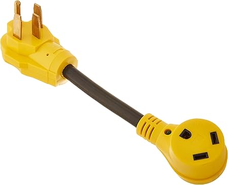

Our microwave isn't on the inverter either.  Somehow this conversation has taken a different turn. lol  The question I had was that the 110 portion of the dogbone wasn't working and I wasn't sure why.  It's not a big deal but the dogbone was expensive and I felt like it should work.
Is there ANY way you can post a picture?  A link to where one can buy the 'dogbone' you have?  I believe that this (picture below) is similar to what people are imagining you have - Like Donc13 posted before. I did not see your answer to his post.
You evidently have more. The post title reads "50 amp to dogbone splitter to 110 amp".   I am ASSUMING you mean 110 VOLT not amp. Correct me if I am wrong, please.

This quote would make me think you have your 50A shore power connected to your 110 volt circuit, with an adapter like this:
I have read here that a 2552 is a 50A  coach, with 'most everything' on one leg, and the second AC on the other. (PLEASE correct me any other 2552 owners!)
It is possible that the adapter shown above only powers one leg of the 50A outlet. Dunno. But if that IS the case, it may be powering only the 'second' leg and the second AC. Nothing else. AND that would have a label that states that you cant use it on a GFCI outlet. Thats TWO clues that match.....

JSanford just PM'd me with a link to this splitter/adapter.
http://www.camco.net/adapters-dogbones/50amp-power-grip-power-maximizer-adapter-adapter-55025
 tymote tymote tymote tymote   OK... now  wonder if he is plugging it in to a 30A RV   *and* a 15A 110, or just the 15A110V.... and hoping it will work. Which it might... I would have to see how they have things wired in the adapter.
 Maybe his house has a 30A RV and a 15A residential socket close enough together?   Reading the questions on the Amazon site, it sure looks like it would NOT work at most RV park wired to code..
(https://www.amazon.com/dp/B0024E70L2)
""Only will work it the 15amp plug receptacle is a non-GFCI plug. So, if you want to use this at the campground pedestal, you will most likely be out of luck because NEC code dictates that outdoor receptacles be GFCI or fed by a GFCI breaker.""
""Question: Can this be used with only one of the male ends plugged in, not both?
Answer: You can but you will only have on circuit functional in your RV. This device keeps the two legs separated and normally brings in 30 amps on one leg and 15 on the other. If you don’t plug in the 15 amp line you will only get the 30 amps service on the one leg.""
So...if just the 110V 15A was plugged in, there is a possibility he would only have the second AC circuit powered.
But it DOES look like he has a 50A shore power cord.  At least we got that!
