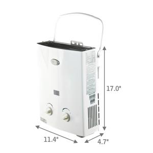

Another adventure begins.... an on demand water heater.
Well, we were hoping to upgrade our water heater from an Atwood 6 gal to an 'On Demand'. We had a ''Marey' brand OD heater that worked like a charm camping, and wanted that same convenience on board the coach. No waiting for hot water, and endless. The Marey runs on 2 D cell batteries, a pressured water source and LP. 3 years old, and going strong! A deal for $125.  https://www.amazon.com/Marey-Portable-Propane-Tankless-Heater/dp/B005DROEZC
