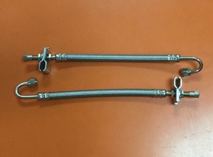

I went down to the garage to check out our 2007 PC with the stainless steel valve extenders.  We have very short seemingly steel valve stems.  The outer tires have a 180 degree steel valve extender and then the stainless steel braided lines.  The arrangement seems ripe for fatigue failure.
It is hard to tell without taking it apart, but I think we have this which seems worse than a TPS hanging on the end of the valve stem.

As I understand it, if the valve stems are steel there is no problem.  I was researching TPMS systems and came across at lot of complaints about the valve stem failure after a TPMS was installed.  The problem occurred with different TPMS systems and different coaches.  The common thread seemed to be that the valve stems were rubber, not steel.  The recommended action was to have rubber valve stems replaced with steel.
I have not heard of this issue with any Phoenix unit, so possibly they have always come with steel valve stems and it is not an issue on our rigs.
Also, your extenders shown have a clip that anchors the extenders to the rim I believe.  That also seems to solve the issue as there is no chance the rubber stem is going to be rubbing or bouncing against the rim as reported by the people with failures.  Some people reported failures with similar extenders as you show, but only after the clips came loose.
