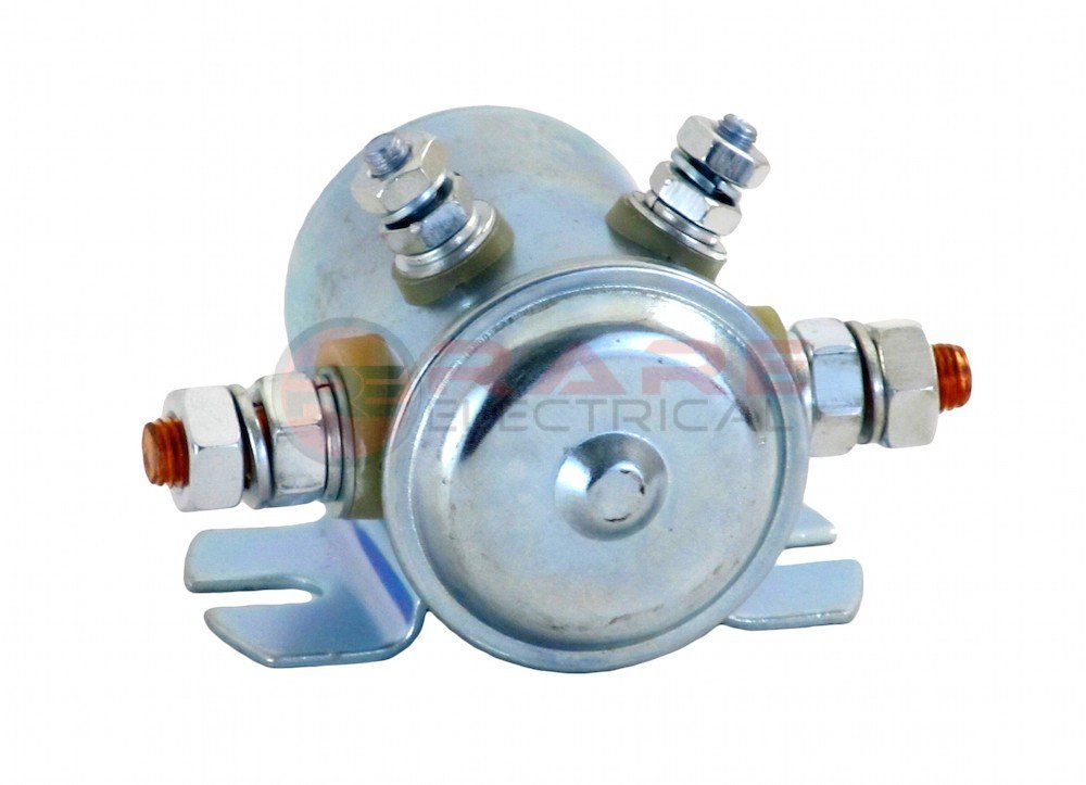

In our 2007 PC, when I use the kill-all switch by the main entry door, a solenoid is tripped.  We hear it well by making a loud "CLICK".  The thing resembles this, though the quality of connections may differ.  If you don't hear the "CLICK", maybe that thing is faulty.  I would tap it with a hammer to jolt it loose, but NOT to dent it.  If you fixed it, then you need to replace it.
