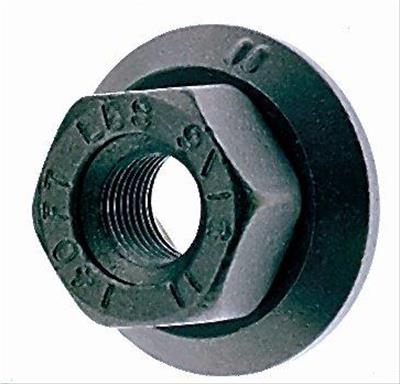

2. I took the stud extension and threaded it onto the thread that stuck out past the lug nut, and added 2 flat washers to each stud extension (for spacing and a stop for the nut). Note if you don't have 3 threads past the lug nut for the stud extension to thread on to you need to purchase a thinner lug nut, part #139987.
AWESOME writeup!
I was fortunate to have an old (2007) PC, so the bolt-on were standard. LOVE them.
But... when i did my front brakes, the autozone front discs had studs that were about 1/8 shorter on the threaded part.  :beg
I did not fully 'appreciate' this until installing the wheel covers, and finding some of the hold down nuts did not have enough thread engaging.
REALLY wish i had known of the shorter lug nut, I milled ~1/8" off the top of the lug nuts. PITA. THANKS for the info!
And is it just irony the brand of the lug nut you posted was Phoenix ?!?!? roflol
https://www.summitracing.com/parts/pho-139987?seid=srese1&gclid=CjwKCAiAzJLzBRAZEiwAmZb0aq_DF48dscLo6uf0ScObzzYqBfBKyuKljW_pKXYKLhQYluH1ExefohoCdTYQAvD_BwE
