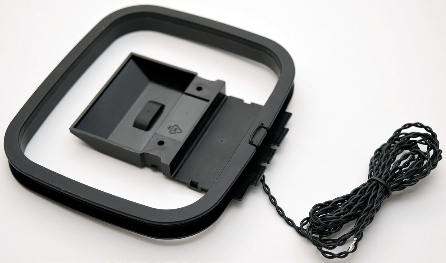

No matter where I go, most of the time I only get 1 radio station. The radio is in my DVD player. I get all kinds of stations on my cab radio. Any fix?
  Lynn
Re: radio
« Reply #1 on: June 18, 2018, 06:27:48 pm »
You have a new 2018.  We have a 2007.  I do wonder if you have an am/fm antenna inside the cabinet above the unit like we do.  Our antenna resembles this.  If you have no such inside antenna, it could be that PC is hooking up the head unit to the roof-top digital antenna.  That would make more sense since they stopped installing the old crank-up antenna that we have.  There should be some kind of antenna connection on the back-side of your head unit.  Maybe it's there, you just need to plug it in.
